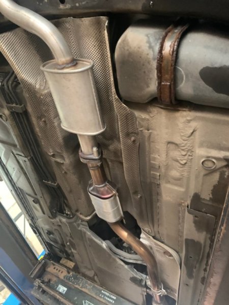

Pic of the exhaust system, attached.

None of those are proper ones - consider that a scrap Z3 converter is worth £400 upwards. I'd look for an original BMW one made by Eberspaecher and pay £500. Or, just fit a cheap new one the week before the MOT.
Cat theft is rife though. There is a Z3 on a driveway near me under a tarpaulin and some scum chopped the cat off in the middle of the night. That's why I have a cheap crap one on mine and will only refit the original for the day of the MOT test.
Your car has a cheap aftermarket cat btw.
Due to the age of Z3s the cat doesn’t have to be “type approved” which basically means the manufactures can make cheap crap which doesn’t (usually) last for more than 1 or if you’re lucky, 2 years.

I've had decent luck with BM Catalysts - they've always passed the first MOT at least!

A cat thief with half a brain* knows that the copy ones like yours are worth about 14p and a Twix.
