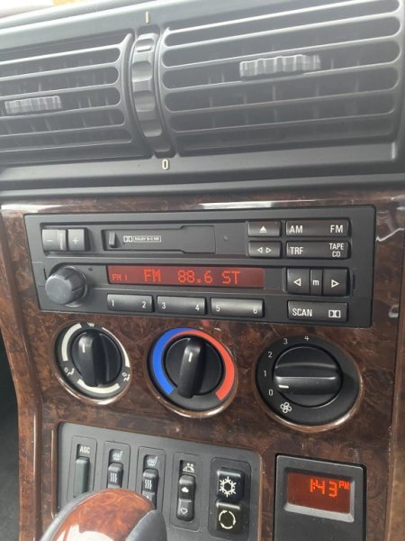

I had the Valencia in my Zed when I bought it with a separate aerial in the windscreen. It matches well but it would only tune into DAB stations which out in the sticks where I live was not very good! FM would not tune in at all, I think something to do with the way the original radio is wired. I replaced it with an original radio/cassette unit which works perfectly for FM.
So for sale is a perfectly good Valencia unit with cage & wiring adapter!
