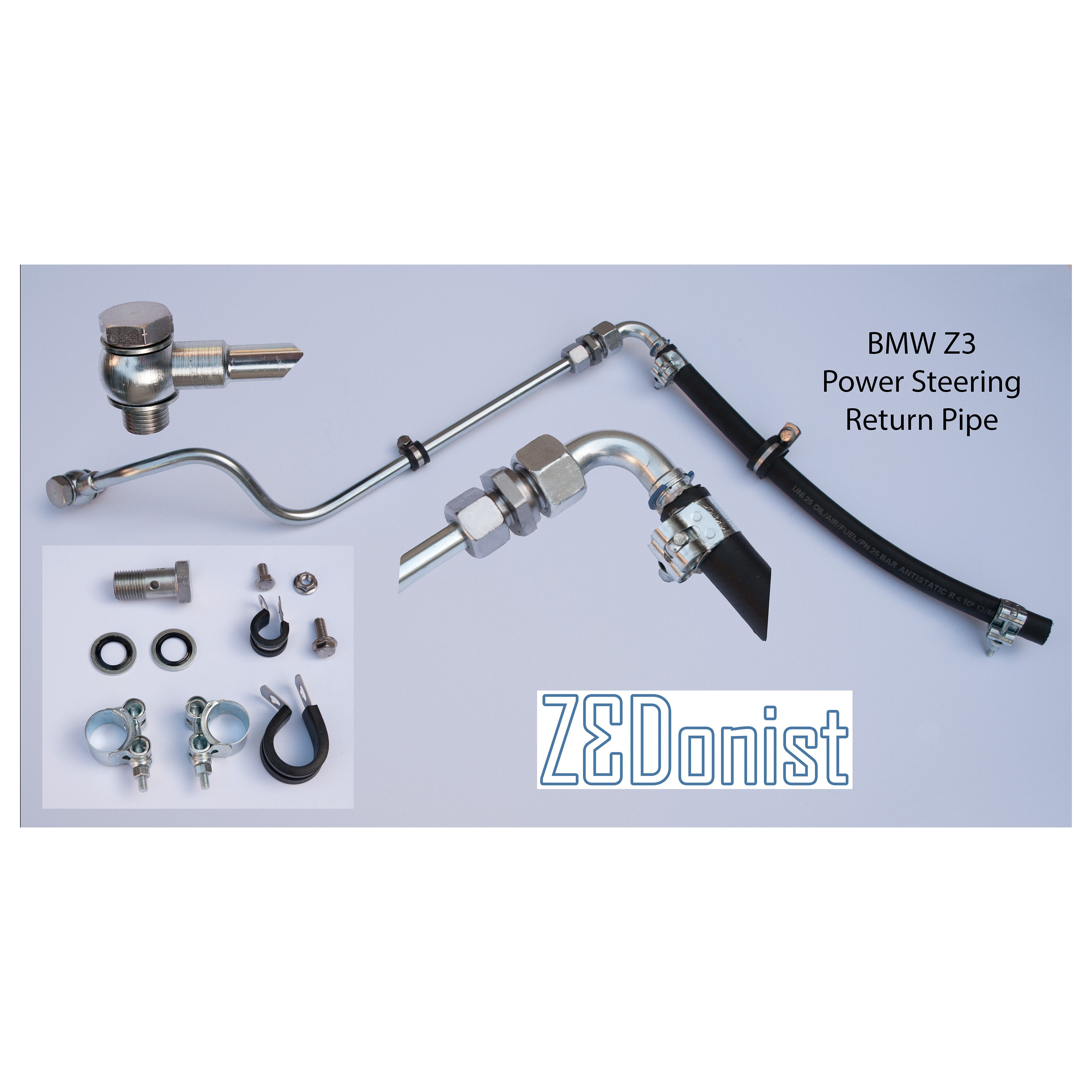

Good call by @Trevor /chedder regarding the power steering fluid. Just had a Z3 in and found the metal fluid pipe along the front of the rack is rusty and showing signs of damp fluid loss. All of the pipes both metal and rubber need looking at as well as the cooling loop in front of the radiator for leaking joints and rusty pipes developing holes. Loss of fluid or low level could be the cause of what you are experiencing. If the metal pipe needs replacing it is no longer available from BMW but @ZEDonist UK on here has had replacements made and are available on his website
