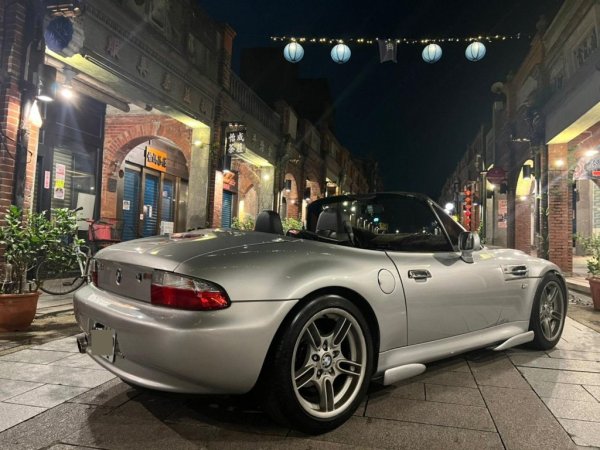

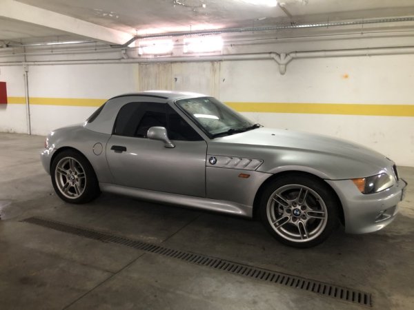

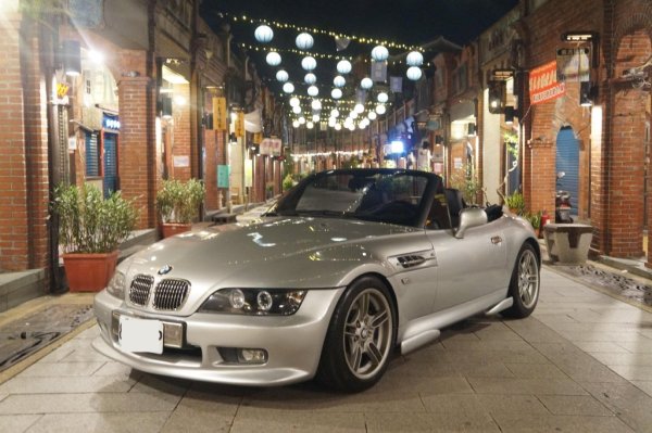

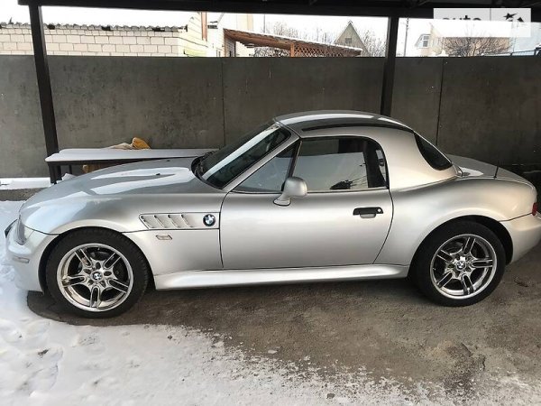

I did a poor photoshop once as I really like that wheel and they quite cheap to buy used:
Of course this a photoshop so I’ve just made them fit!
I did see a pic of a Z3 with the fitted but cannot find it now.

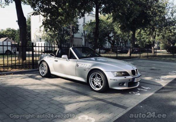

Found the thread- here is a Z3 with 5 series wheels, it’s style 32 but same width and offset as the style 66 I believe:
https://zroadster.org/threads/mor61es-topaz-2-8-z3.15959/
It’s worked here with some lowering and tyre stretch.
I can’t run my car that low but want to investigate how much camber I can run as I’d like to run some 5 series wheels - I like the style 32 and 66.

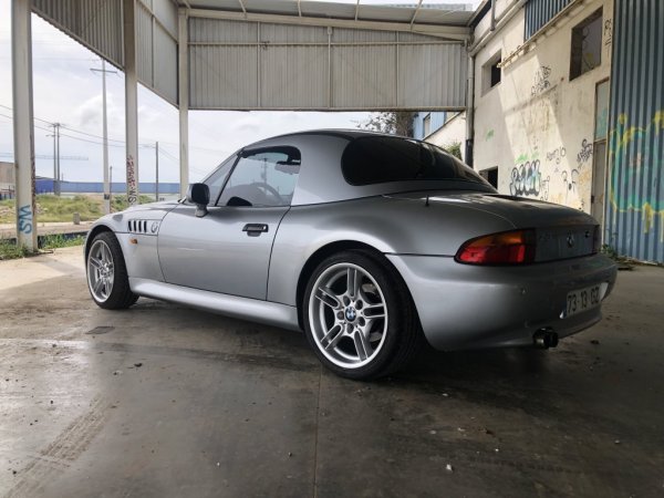

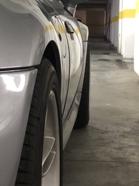

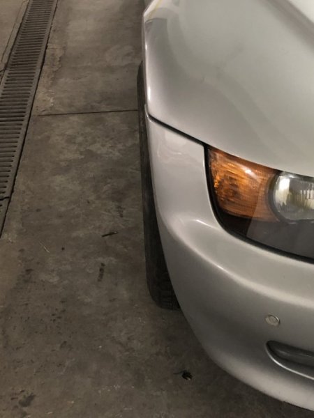

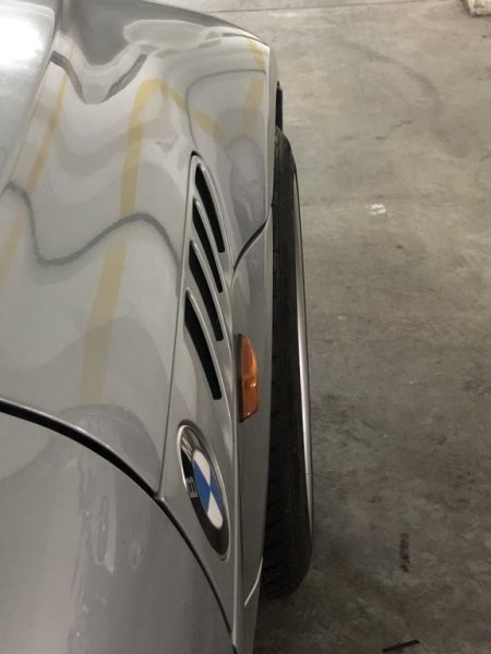

Rafaelbrs
Mar 11, 2023
4
hello friend!!!

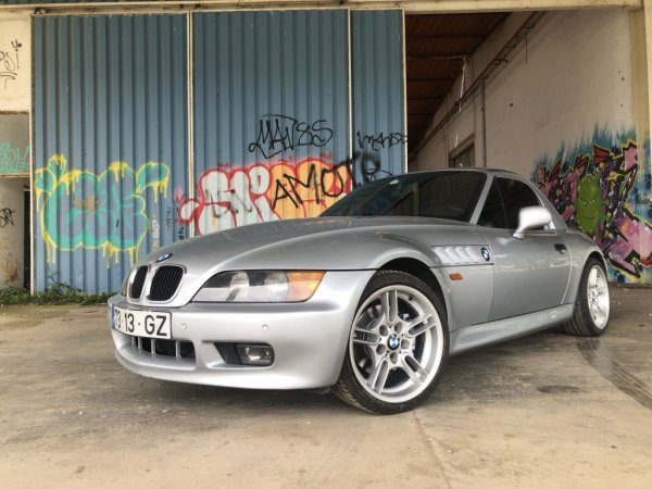

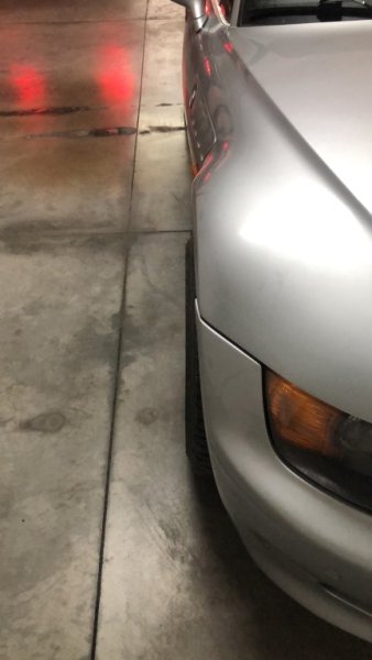

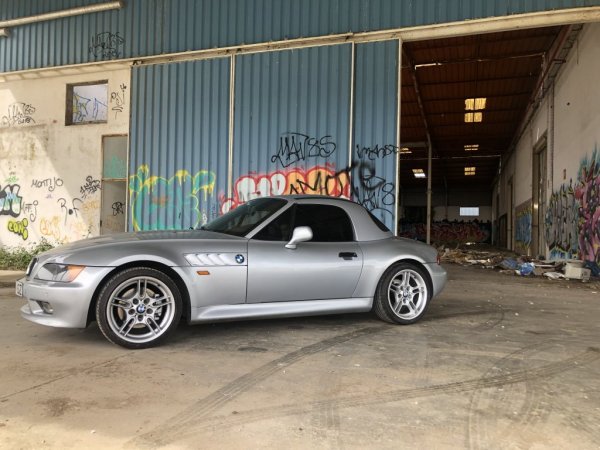

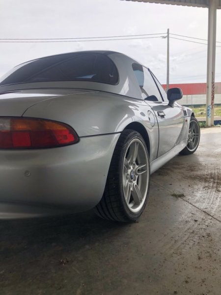

I love the style66 rims and I see some photos of the Z3 with them and I decided to buy a set 17"x8" et20 there are just another 9" et29 (thankfully
I didn't opt for these because my z3 isn't an M). it happens that at the front they come out a little, beyond that, with
tires larger than 205/45/17 touch the mudguard plastics.
someone Can help with what!
I was thinking and I just remember that I can put the suspension arms of BMW E30 and maybe I need some camber plates...
any more ideas....
I love the look of the Z3 with these rims, please give me some help

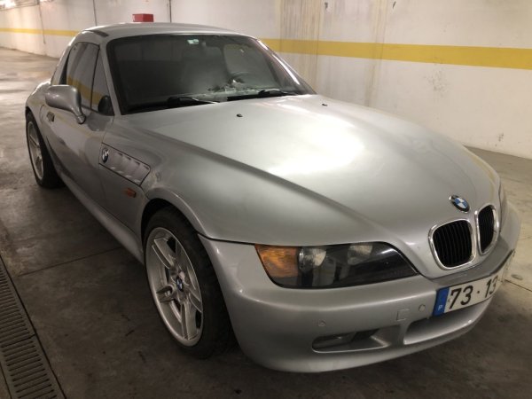

For now it's done!!! I don't care about the police... it's beautiful and with the 205/40/17 tires it won't touch anywhere. For now I'm going to enjoy the car like this and with time I'll look for a solution.

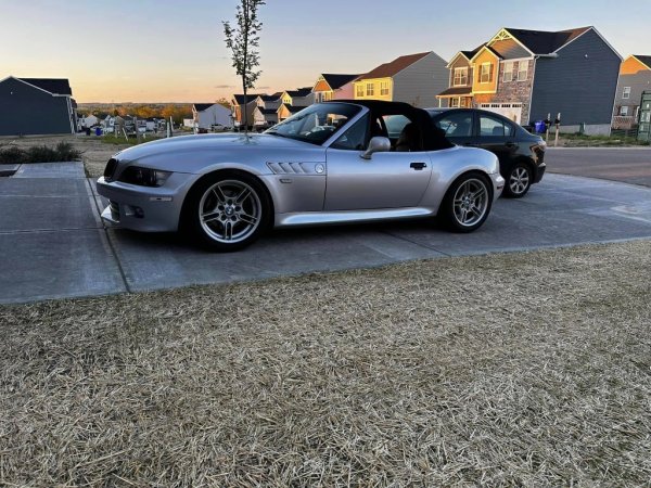

I've gone down the rabbit hole and are installing some staggered Style66 wheels 17x8, 17x9 on my 1997 2.8 manual. I've installed some 20mm spacers on the original 17x7.5 and 17x8.5 wheels and they fit nice. I also have front camber plates and rear adjustable bushes so the alignment geometry is dialed in & optimised for handling. I have also selected some sticky Yokohama A052 tyres, as the current Michelin PS5 are reasonable but nothing like the Yoki's. I have them on another vintage bmw and they stick like a cat to carpet i wet or dry. I know the wear is not great but mine is an occasional use car, so I don't see the point in selecting good mileage tyres and replacing them due to age with heaps of tread left.

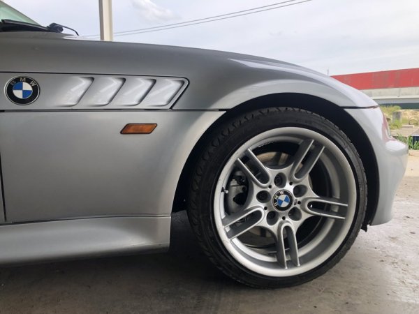

Really lovely wheels the Style 66 and look great on the Z but sadly the front wheels poke too much unless you are prepared to run skinny tyres or other mods.
As a rule of thumb 8.5x 1X et 41 which is equal to 8x1X et35 is the furtherest out you can have a front wheel before it starts poking out the wheel arch with correctly fitting tyres.
Another option is to run camber plates. This is to add more negative camber (inward). With this, there are also additional drawbacks which will likely be decreased tyre contact area and additional tyre wear.
The rear 17x9j et26 rear is pretty much perfect which is annoying as most 5 series fronts are 17x8 et20 which is 15mm too much poke, like these style 66s.
I run a mixed wheel setup with 17x8.5j et41 on the front and 17x9 et26 on the rear. I used the standard z3 rears on the front and use e39 fitment on the back.
If I say so myself, it's spot on.
