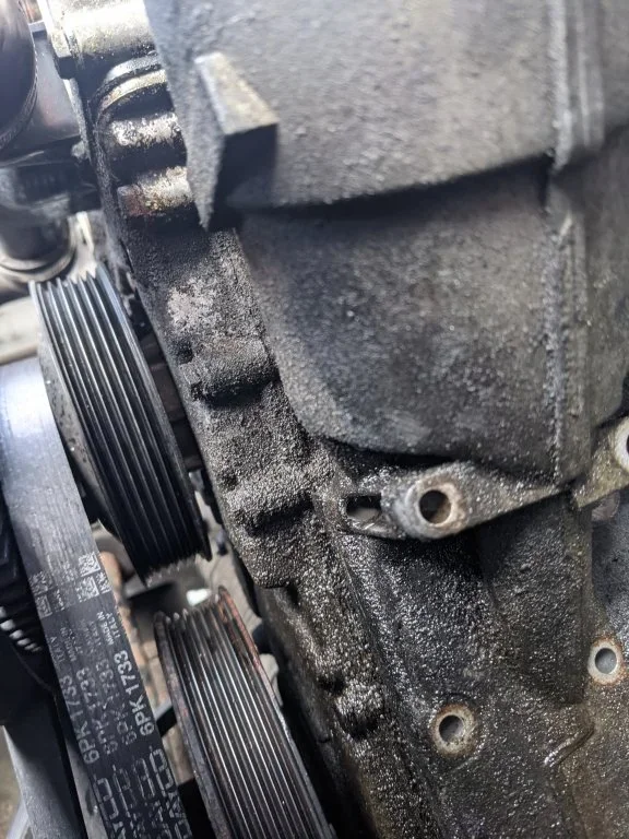

Hi,
After 2 hours draining and disassembling the engine to get to the oil filter housing the top left bolt broke.
And it broke in the most inconvenient spot. I cannot weld on top of it because the hole is too small and I need a long and thin drill bit to extract it.
Every mechanic in Stoke-on-Trent is busy until next week and I am lost.
Can is dry sitting on ramps and the plan is to get some long thin drill bits tomorrow and try make a clear hole before using the extractor.
But I have to use the extractor at an angle anyways... And it doesn't seem to work.
For now it's sitting with a lot of WD40 in there.
If I could I would break the bolt in two so I can have access and then extract one half from the housing and the other from the engine.
I don't want to put a screwdriver between the engine and the housing to try and brake them apart with the screw in case I damage the surface and end up with leaks.
I am lost. Thanks for any help.

Has the bolt broken off near to the block Mike? I can’t see it in the “slot” in the housing. I would try to lift the housing gently with a pry bar at the bottom, if you can get a small gap then try tapping the housing at the bottom towards the front of the engine to “rotate” it on the broken bit of bolt. Give the hole a soaking of penetrating oil over night.
The housing looks like it is ready to come off, and then you can get mole grips on the broken bolt.
The housing probably just needs a few taps with a rubber mallet or a block of wood and a hammer to break the seal
I tried but the bolt is a bit too strong. I thinking i could cut the housing with an angle grinder, remove the bolt and buy a new housing.
But ill try using a bit more force maybe that will help.
Give it a good tap all round, its going to be easier to get at whats left of the bolt with it off and out of the way, no point having a struggle with drills and an extractor with it still in place.

It is broken near the block. Its only a few threads that hold the housing.

Thats what I thought, so try to break the seal by lifting the housing at the bottom as I mentioned.

I will try that. I am just a bit scared to damage the surface of the block.
Next thing to do is hit the stud on the end with a hammer, straight on NOT sideways. Then if you have and flat jawed Mole Grips clamp them onto the broken stud a tight as you can manage. Try to move it in a tightening (clockwise) direction before try to undo it.

I cleaned everything, put towels and covered exposed engine parts. Will finish everything tomorrow.
Bolt is still stuck in there. I dont have jaws, clamps or pliers good enought for this.
Tomorrow morning i will go to a few shops get those tools and hopefully it will all be fine.
Thanks a lot for the help! If i cant find a suitable bolt ill tell you. Thanks!!!!! This forum is so great!

What does hitting the end of the stud straight on with a hammer do Tony? Just curious
Could be worth filing some flats on the broken bolt for a better grip
It simply "shocks" the seized parts and often makes the releasing easier. It does the same thing as trying to tighten the fixing before loosening.
I always recommend using flat jawed grips because rounded jaws tend to round things of much quicker than flat jaws.
Today I finally fixed it.
NES industrial fasteners in Stoke-on-Trent has any bolts you need and was only 2£ for 5.
I ended up braking the right top bolt with my torque wrench. It was easy to fix but I wouldn't torque those small bolts. Hand tight seems to be fine.
But hammer really helps with this gasket replacement. Used it a lot more than I expected.
