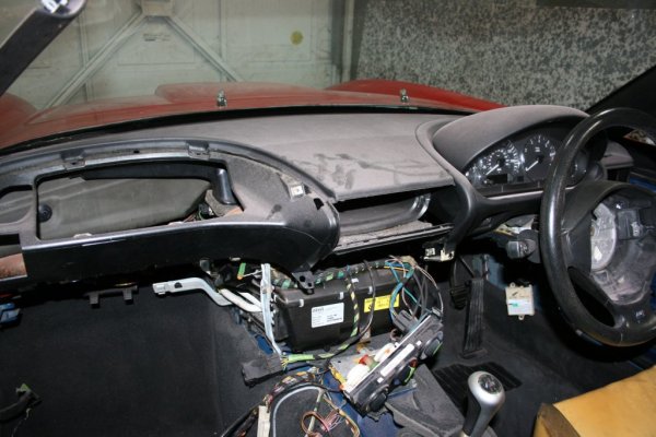

The dashboard is three pieces. The main section, then the instrument binnacle and the passenger airbag section.
Hopefully the picture may help a bit. It is a bit dusty!

As shown in the picture above, the passenger airbag 'cover' is screwed in to the dash, so can come out fairly easily. I haven't taken the instrument binnacle off yet, but would imagine it is similar. So in theory, yes you can remove both parts without removing the entire dash.

Both sections have fixing screws that come from the firewall side. People have been able to remove them with the main dash in place, but it's not easy.

To retrim it all has to come out - original trim can be stretched or aftermarket trim bought and applied with the original removed - I have done it twice, once because I was curious, 2nd time because I could.... I now have another dash in the loft with leather trim of the wrong colour that I am contemplating but a 3rd time would definetly be my last.

The passenger and driver's sections come off the same way. The screws are from the under side so the whole dash would need to come out to unscrew and remove those two pieces.
Ignore me cutting a bit off. That's a different topic. But you can see where the binnacle screws to the driver's side the same way that the passenger side is fixed
