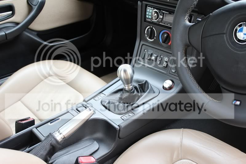

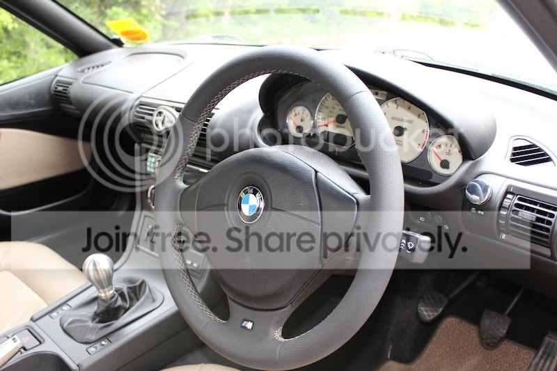

Royal steering wheel and storm Gearknob

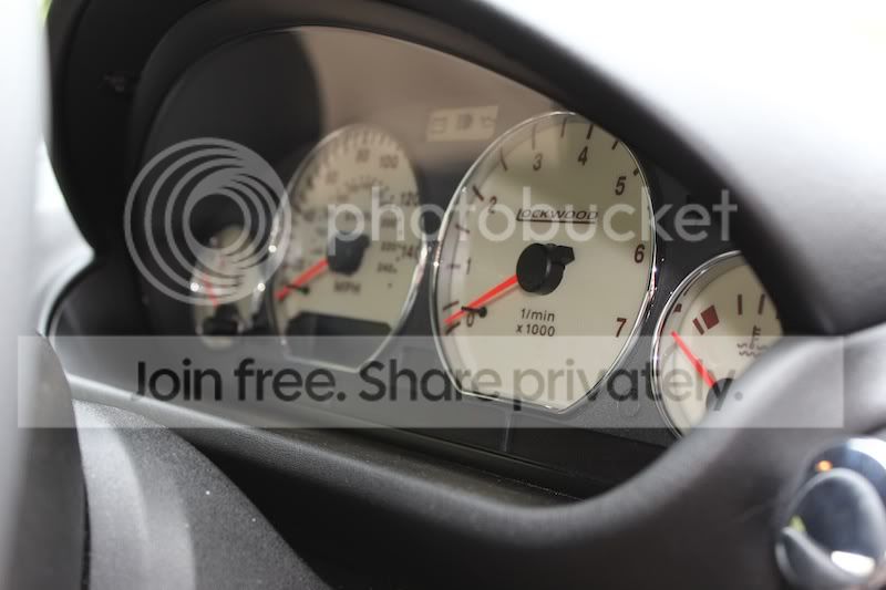

Lockwood dials which have since been replaced by standard after the black interior was fitted.
