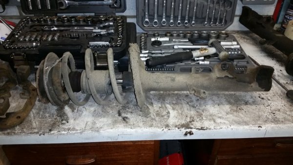

Front shock removed

Shock absorber on the bench ready to break down. Few cobwebs to be swept away ;)
Spring clamps fitted to compress them enough so we can get the windy gun on them to remove the top nut.
