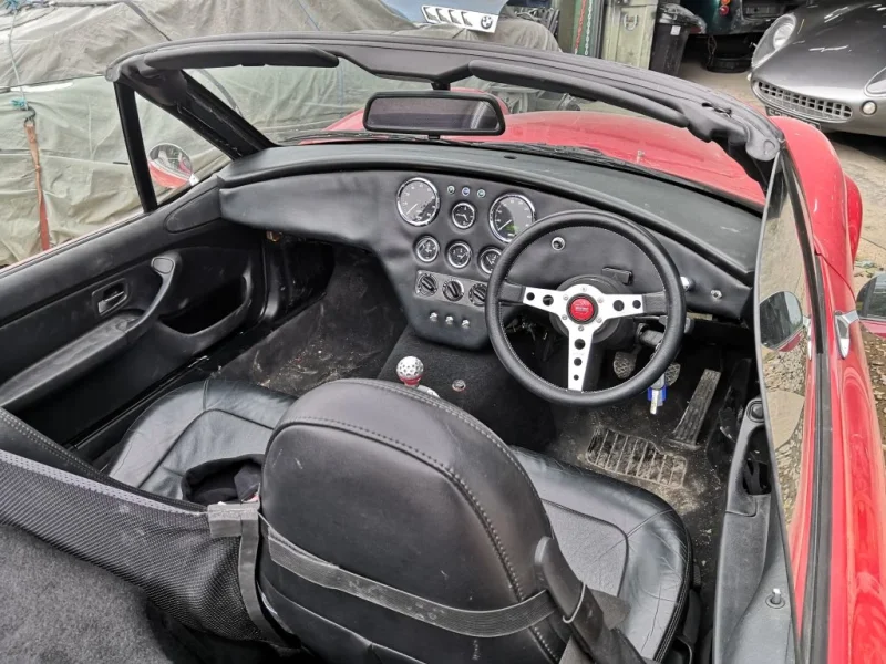

Here's a picture of @Pond's dash that I've chopped up and stuck back together - Remember - Squint - Squint a lot .

Looking at the 507 dash and making something like it for the Z3 is gonna be tough IMO. One obvious problem is the steering column covers. You need something on the Z3, as there is a massive ignition assembly (unless you cut that out) and the indicator/ wiper switches which I presume you ain't gonna delete.
Another issue is going to be the crash bar. It is going to get in the way of everything unless you can pull your new dash in front of it, including all gauges..
It's tricky enough with a dash that was supposedly made for the Z3, so I wouldn't even like to consider making one from scratch.
Did you read my post? I didn't say make from scratch. I said taking YOUR 250 dash, or the one from Tribute, made for the Z3, and adjusting the facia.

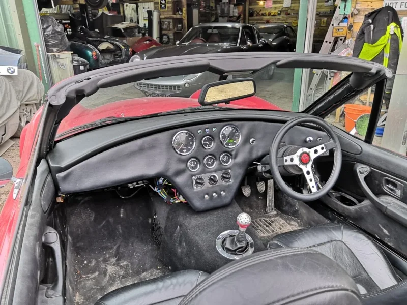

My kobra dash is nice and flat. You could place a binnacle in front of it maybe. I also kept the existing heater controls in place. Please ignore the terrible dash covering. I've never done one before , or ever again.

I like my two tone dash with the extended leather option. No way I could go through the stress of chasing wires all over the place now.
So few people know what the original dash looks like, I don’t have an issue.
Sorry but that picture looks just the interior of a Z3 (cos it is). I know everyone is different but I just don't understand; why go to all the trouble (and expense) of changing a car to look like something else but it looking the same as it started on the inside.
I know it's up to the individual to do whatever they like, but I just don't get it and don't think I ever will.
To my mind this 'changing' a car to 'be' something else has to be all or nothing, or what is the point?

But in the end. They are all Z3s underneath whatever we do to them. Always will be but as long as we understand and accept that then it doesn't matter.
I like everyone's Rebody attempts on here because they end up to be what we wanted and pretty unique cars.
Different strokes for different blokes.
