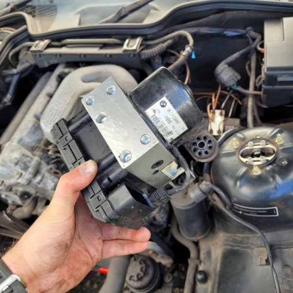

I am having a bit of a push again. I've got a new/ used abs pump in bound and a new radiator. The alternator on this engine is dead as well. I really need to get the other one back to the house.

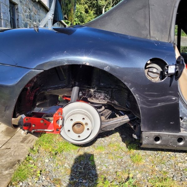

I've had a quarter panel in the shed for replacing the picky one. The new one needed a little rust treatment as well but really not bad.
Once I got the panel off, I came across an aftermarket hole, so i zipped it up.
And a coat of paint

The wobble is fixed and the interior is in. I've still to dye it but it'll do for the MOT. The car is looking pretty funny just now with its mutli colour appearence.
I've recieved and fitted the abs pump thanks to @Andyboy for the speedy delivery. I've still to bleed the brakes but first up is trying to code the module to the car.
