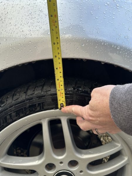

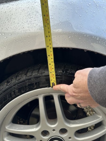

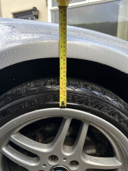

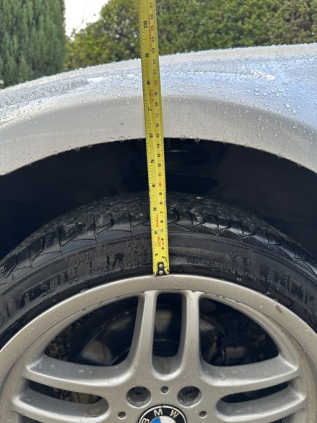

Can i ask you to do something .
Go park the car on level ground ( not at edge of a road as cambered) and can you measure this gap .
So vertical from centerline through wheel measure gap between top of rim to bottom of arch ( as in pic ) on all 4 corners tellme what measurements are please if thats ok.

Okay. All measured. Photos attached but noted dimensions below also. Pics not in list order.
OSF 125mm
OSN 150mm
OSR 118mm
OSR 121mm
Garage are having it back on Monday. They don’t know what the issue is?!

OSF 125mm
OSN 150mm
OSR 118mm
OSR 121mm
I think (think!) you mean nearside front 150mm, offside front 125mm, offside rear 121mm and nearside rear 118mm.???
I would have expected the nearside rear to be much lower, given that the opposite front is sitting so high.
